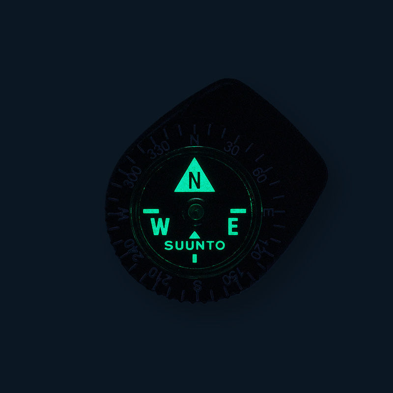

Micro compass that consists of a housing that has a built in 22 mm wide clip that can be used to attach the compass to the edge of a map, to a strap, or to the sleeve, and a liquid filled compass capsule with a compass card with luminescent feature, and a rotating protractor around the compass capsule.

Protractor diameter: 25 mm
Primary direction scale: On top of rotating protractor alligned with outer edge, DEGREES scale 0-360° clockwise with 10° resolution and a number ever 30°. Diameter: 25 mm. The protracor rotates in 10° steps.
Cardinal markings: N, W, E on compass card
Magnetic balancing: Northern hemisphere with much of southern hemisphere covered as well.
Needle design: Compass card with cardinal markings and a triangle pointing north.
Needle length: 16 mm card
Needle movement damping method: Non-freezing transparent liquid filled compass capsule.
Compass capsule: Hermetically sealed transparent PMMA capsule, diameter 18 mm.
Orienting arrow: The bezel 0 degrees mark acts as orienting indicator for the North mark on the compass card.
Protractor index: Combined direction of travel arrow and index line next to the protractor.
Luminescent features
Luminescent material: SrAl2O4
Compass card: Luminescent north triangle and cardinal markings
