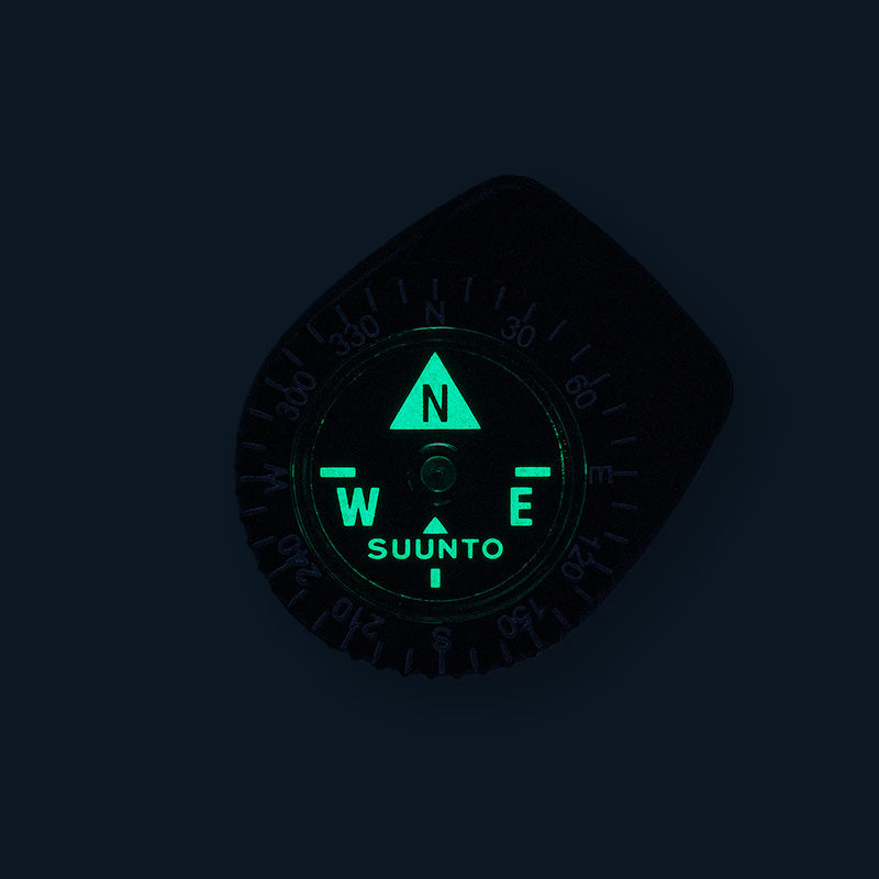

Micro compass that consists of a housing that has a built in 22 mm wide clip that can be used to attach the compass to the edge of a map, to a strap, or to the sleeve, and a liquid filled compass capsule with a compass card with luminescent feature, and a rotating protractor around the compass capsule.
Suunto Clipper
L/B SH Compass
Suunto item: SS004102012
Contact Us for Military Procurement
For defence procurement, tender participation, or inquiries about custom compass development:
Our dedicated defence sales team is ready to assist with your requirements. You can also follow us via Facebook and Instagram.
Physical specifications
Product dimensions:
30x24x11 mm
Net weight:
5 g
Package dimensions:
71x17x101 mm
Gross weight:
35 g
Operational temperature range:
0˚C .. +60˚C . The compass will get a temporary bubble that increases in size as the temperature of the compass drops until the bubble does not allow the card to rotate at about -20˚C. The compass may become damaged at temperatures below -30˚C.
Water proofness:
Waterproof to all practical water depths as there is no cavity that can leak water in.
Storage temperature range:
-30˚C .. +60˚C
Berry compliant:
Yes, no fiber material in the product.
Compass needle/card and protractor specifications
Protractor diameter:
25 mm
Primary direction scale:
On top of rotating protractor alligned with outer edge, DEGREES scale 0-360° clockwise with 10° resolution and a number ever 30°. Diameter: 25 mm. The protracor rotates in 10° steps.
Cardinal markings:
N, W, E on compass card
Magnetic balancing:
Southern hemisphere.
Needle design:
Compass card with cardinal markings and a triangle pointing north.
Needle length:
16 mm card
Needle movement damping method:
Non-freezing transparent liquid filled compass capsule.
Compass capsule:
Hermetically sealed transparent PMMA capsule, diameter 18 mm.
Orienting arrow:
The bezel 0 degrees mark acts as orienting indicator for the North mark on the compass card.
Protractor index:
Combined direction of travel arrow and index line next to the protractor.
Luminescent features
Luminescent material:
SrAl2O4
Compass card:
Luminescent north triangle and cardinal markings.
Clip:
Clip integrated in housing of compasss. Can be used to attach to strap, map edge or sleeve.
