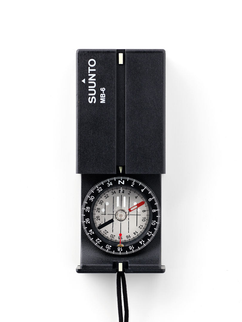

Compass needle/card and protractor specifications
Protractor diameter:
42 mm
Primary direction scale:
On top of rotating protractor alligned with outer edge, DEGREES scale 0-360° clockwise with 2° resolution and a number every 20°. Diameter: 40 mm.
Cardinal markings:
N on protractor
Magnetic balancing:
Northern hemisphere with much of southern hemisphere covered as well.
Needle design:
Red for north and black for south. The needle has a luminescent area in the north end. The markings of the needle are the same on both the upper and the lower side. The center of the needle is transparent and the damping shape of the needle is also transparent. The hub of the needle features a NdFeB ring shaped magnet.
Needle length:
32 mm
Needle movement damping method:
Non-freezing transparent liquid filled compass capsule with the absence of bubbles in the operating temperature range at sea level.

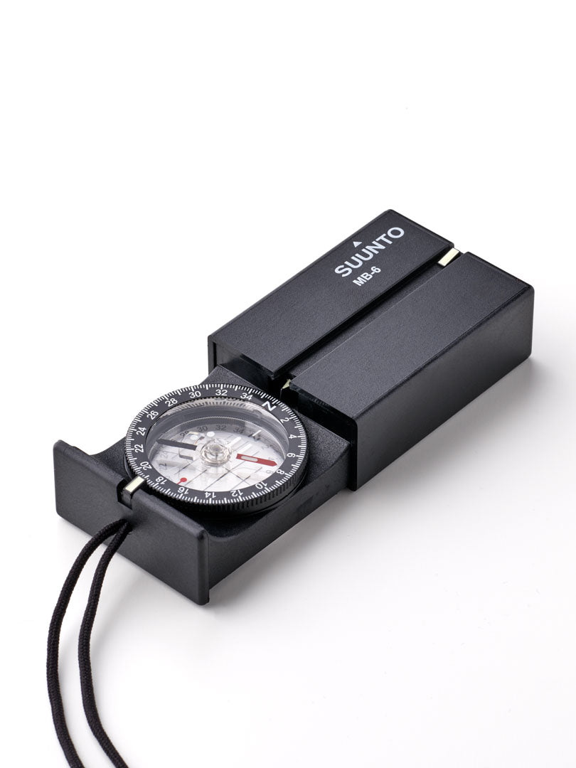

Compass capsule:
Hermetically sealed transparent PMMA capsule, diameter 33 mm.
Orienting arrow:
Two white luminescent lines to allign with the north end of the needle. Two white luminescent dots on each side of the orienting arrow at + and - 60 degrees used to navigate around large obstacles.
Declination corection:
The angle between orienting arrow and orieting lines can be adjusted to compensate for declination. The angle is adjusted by turning a sprocket using a flat screw driver delivered on the lanyard. The declination correction scale is in degrees with a two degrees resolution and is marked with a number every 20˚. The declination correction scale is full 360˚.

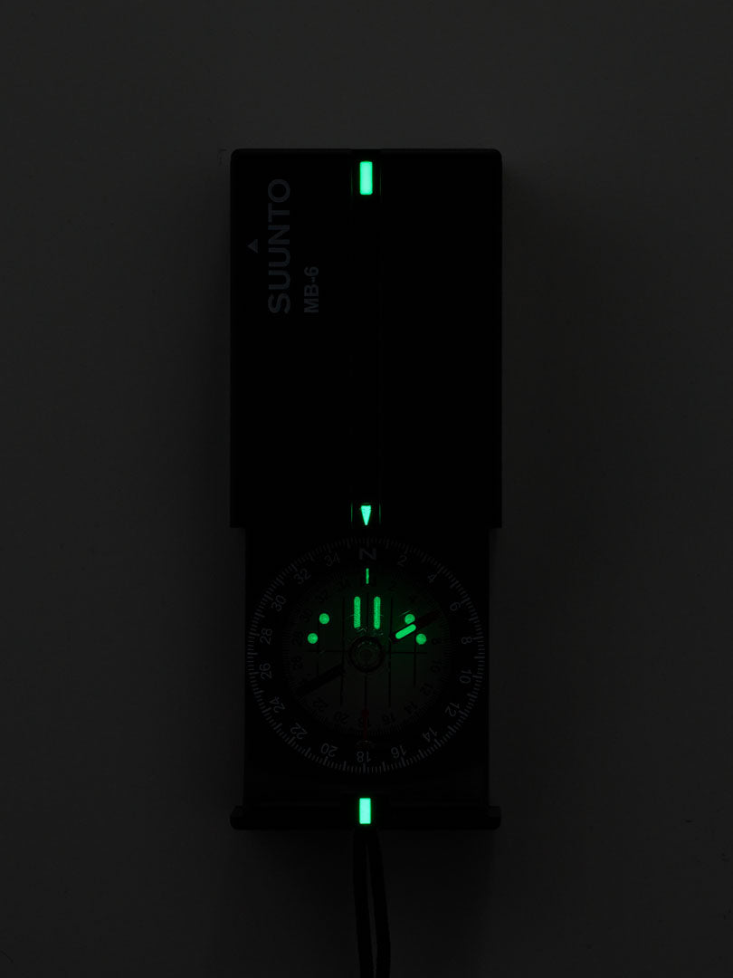

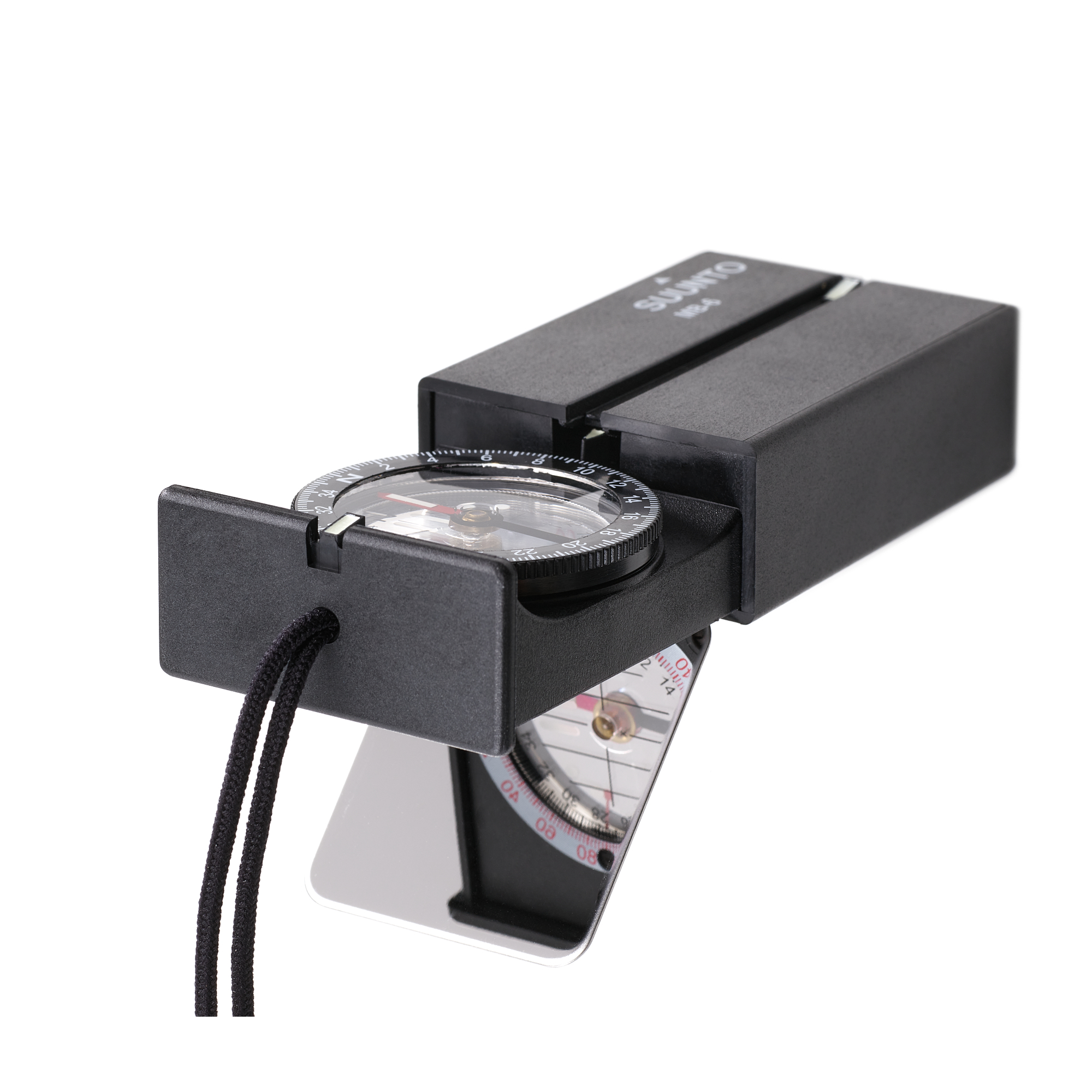

Sighting Tools
Mirror:
Mirror inside the housing that can slide out under the compass and then pushed down in one preset angle. The compass including the orienting arrow and magnetic compass needle can be viewed from below in the mirror while sighting a target with an open sight at the top of the compass.
Open sight:
Open sight with luminous markings on top of compass that is used together with the the mirror under the compass to align the compass with the target.
Luminescent features
Luminescent material:
SrAl2O4
Compass Needle:
Area on the north end of the compass needle
Orienting arrow:
Two lines, one on each side of the north end of the orienting indicator and in addition two sets of two dots showing 60˚right and left.
Protractor index:
Arrow shaped index with luminescent material next to the protractor.
Direction of travel:
Three luminescent features along the center line of the compass.
