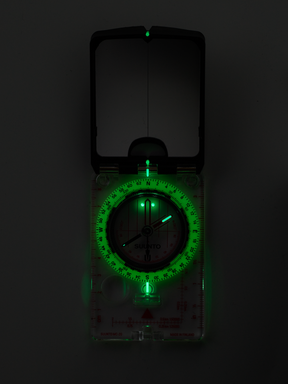

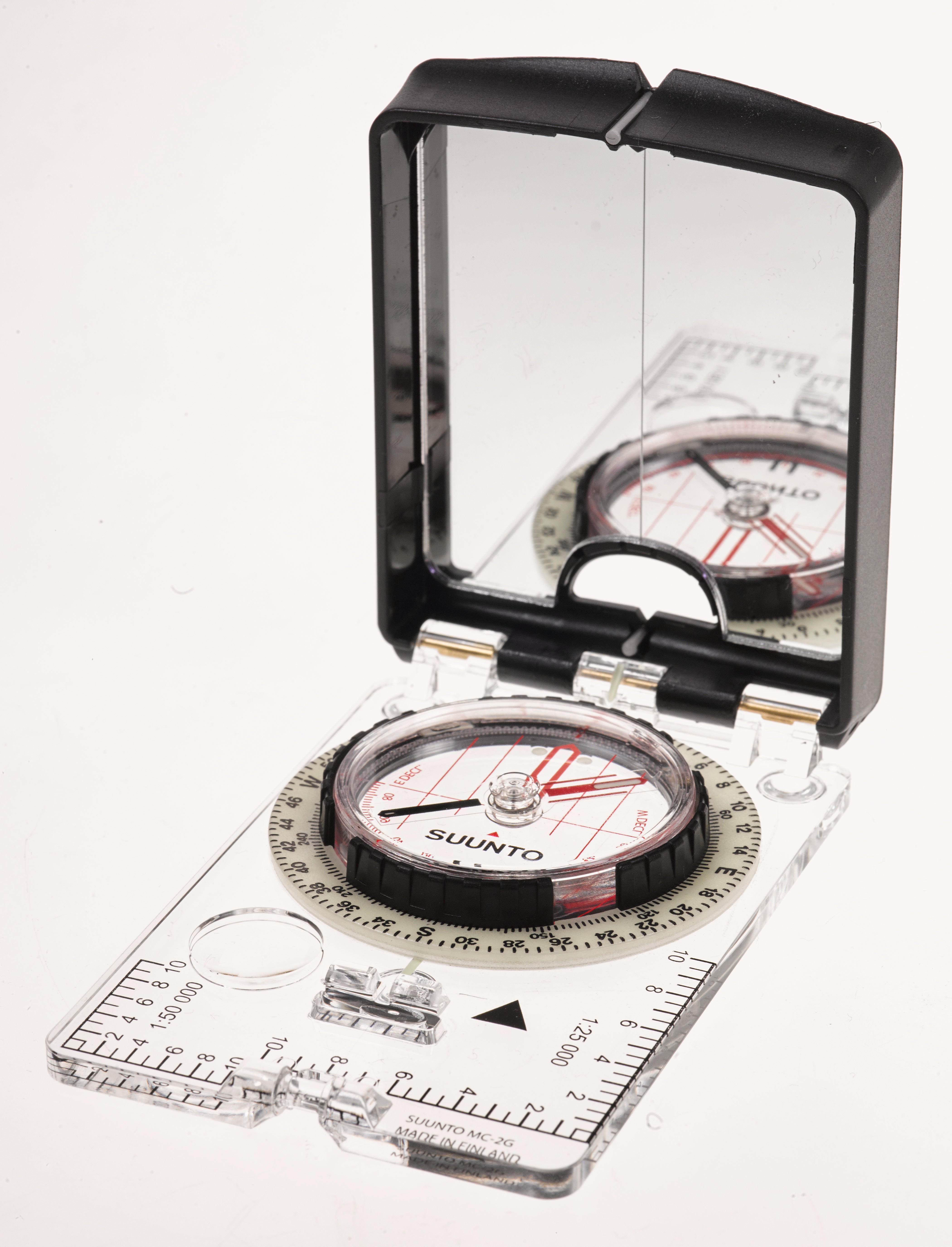

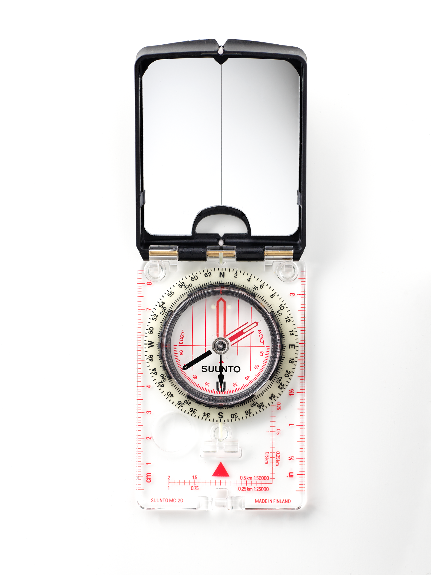

The compass consist of a transparent plastic rectangular base with a circular dial assembly with adjustable declination correction and a liquid damped compass needle, and a rectangular hinged lid including a mirror attached to the base. The compass is non-radio active, magnetic, unmounted, and suitable for field operations in extreme weather conditions.
Suunto MC-2
G 6400/360 Compass
Suunto item: SS050629000
NSN code: 6605-17-110-8584
Contact Us for Military Procurement
For defence procurement, tender participation, or inquiries about custom compass development:
Our dedicated defence sales team is ready to assist with your requirements. You can also follow us via Facebook and Instagram.
Physical specifications
Product dimensions:
65x101x18 mm
Net weight:
74 g
Package dimensions:
180x120x25 mm
Operational temperature range:
-30˚C .. +60˚C
Water proofness:
Waterproof to all practical water depths. The cavities of the product will fill with wather and then drain.
Storage temperature range:
-30˚C .. +60˚C
Berry compliant:
Compass baseplate specification
Baseplate:
Rectangular, transparent, made from impact and scratch resistant PMMA
Magnifying lens:
Yes, 5x
Rulers and scales:
cm and inch rulers, metric partial 1:25 000 and metric 1:50 000 UTM Roamers. Slope rulers on the sides of the mirror lid.
Compass needle/card and protractor specifications
Protractor diameter:
59 mm
Primary direction scale:
On top of rotating protractor alligned with outer edge, MILS (Mil-radians) scale 0-6400' clockwise with 50' resolution and a number every 200' except when number swapped for cardinal marking. Diameter: 59 mm.
Secondary direction scale:
On top of rotating protractor against the compass capsule, DEGREES scale 0-360° clockwise with 2° resolution and a number ever 30°. Diameter: 50 mm.
Cardinal markings:
N, E, S, W on protractor
Magnetic balancing:
Global needle, The needle is independent of the magnetic inclination and functions at all earth magnetic field locations.
Needle design:
Red for north and black for south. The needle has a luminescent area in the north end. The markings of the needle are the same on both the upper and the lower side. The center of the needle is transparent and the damping shape of the needle is also transparent. The hub of the needle features a NdFeB ring shaped magnet.
Needle length:
36 mm
Needle movement damping method:
Non-freezing transparent liquid filled compass capsule with the absence of bubbles in the operating temperature range at sea level.
Compass capsule:
Hermetically sealed transparent PMMA capsule, diameter 44 mm.
Orienting arrow:
Red and black colored, located under rotating capsule
Declination corection:
The angle between orienting arrow and orieting lines can be adjusted to compensate for declination. The angle is adjusted by turning a sprocket using a flat screw driver delivered on the lanyard. The declination correction scale is in degrees, with a two degrees resolution and is marked with a number every 20°. The declination correction scale extends 90° E(+) and W(-)
Protractor index:
One luminescent forward bearing index at the hinge of the mirror lid and one luminexcent back-bearing index line at the opposite side of the protractor. Both lines are next to the protractor.
Clinometer
Clinometer feature:
Black weighted needle hanging from center of the compass capsule when the compass is kept vertically on its side. The declination adjustment scale works as the inclination scale when rotating the capsule so that S on the protractor points to the straight side that is downwards. The scale is read either from the bottom side of the compass when using transversal method or via the mirror when using longitudal method.
Clinometer scale:
Degrees 0-±90˚ with 2˚ resolution
Sighting Tools
Mirror:
Mirror inside black protective lid. The mirror has a center line and can be tilted at äny angle above the compass.The lid encloses the protractor assembly when in the closed position in order to provide suitable protection for the compass.The lid has a V-sight on the top and a hole with a V-sight at the base. The V-sights are alligned with the center line and are luminous.The lid forms a straight line with the sides of the baseplates to form a long straight line tool for working on the map.A catch locks the mirror lid in the closed position.

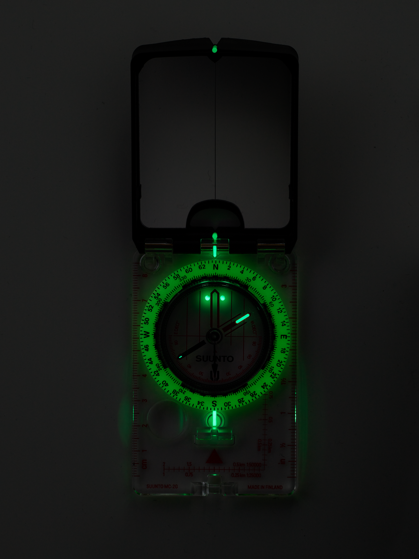

Luminescent features
Luminescent material:
SrAl2O4
Compass Needle:
Area on the north end of the compass needle and a narrow line at the south end of the needle
Orienting arrow:
Two dots, one on each side of the north end of the orienting indicator.
Protractor:
The material of the protractor on which the directional scale prints is luminescent.
Protractor index:
Two lines, one for bearing and one for back bearing along the center axis of the base plate.
Direction of travel:
