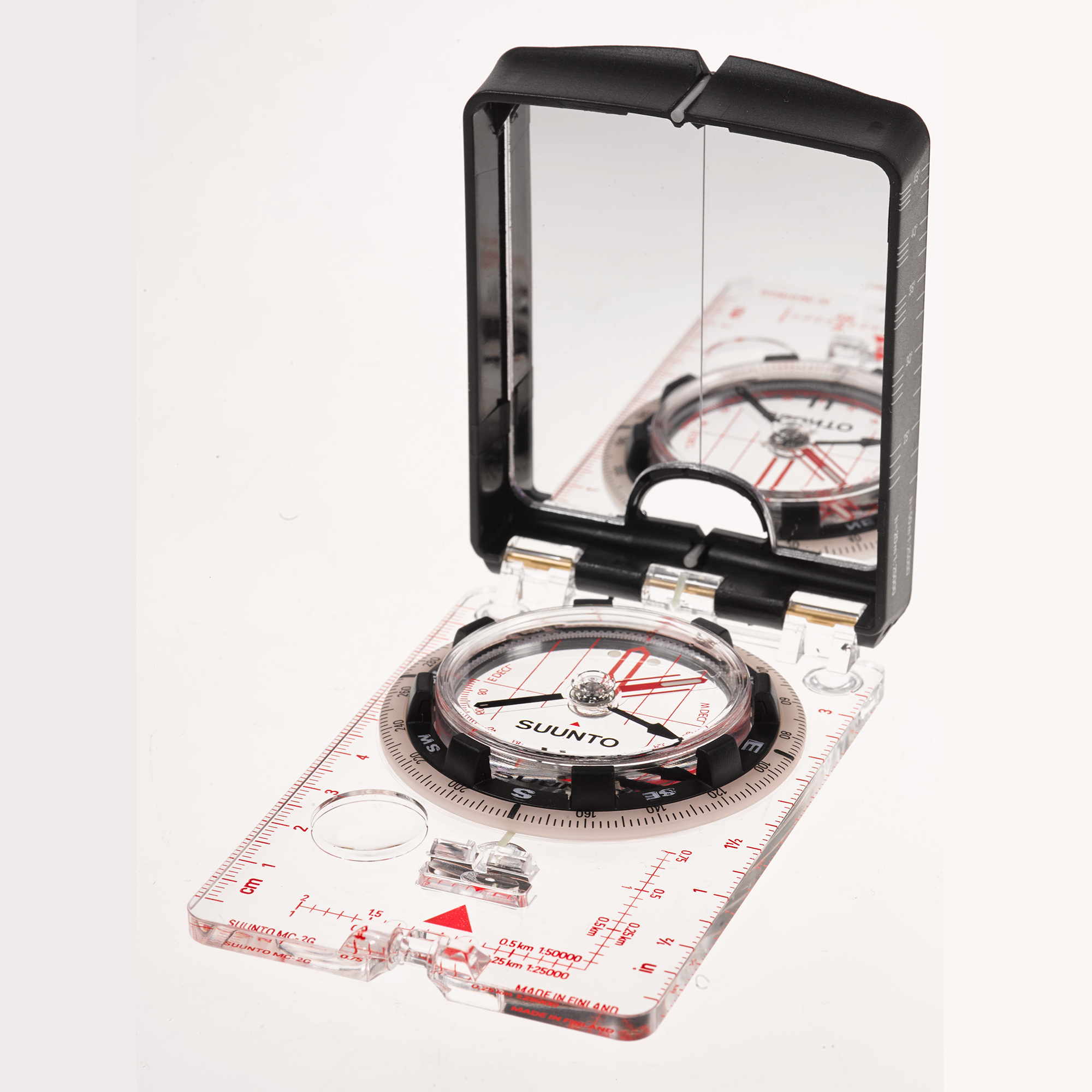

The compass consist of a transparent plastic rectangular base with a circular dial assembly with adjustable declination correction and a liquid damped compass needle, and a rectangular hinged lid including a mirror attached to the base. The compass is non-radio active, magnetic, unmounted, and suitable for field operations in extreme weather conditions.

Baseplate: Rectangular, transparent, made from impact and scratch resistant PMMA
Magnifying lens: Yes, 5x
Rulers and scales: cm and inch rulers, metric partial 1:25 000 and metric 1:50 000 UTM Roamers. Slope rulers on the sides of the mirror lid.

Mirror: Mirror inside black protective lid. The mirror has a center line and can be tilted at äny angle above the compass.The lid encloses the protractor assembly when in the closed position in order to provide suitable protection for the compass.The lid has a V-sight on the top and a hole with a V-sight at the base. The V-sights are alligned with the center line and are luminous.The lid forms a straight line with the sides of the baseplates to form a long straight line tool for working on the map.A catch locks the mirror lid in the closed position.

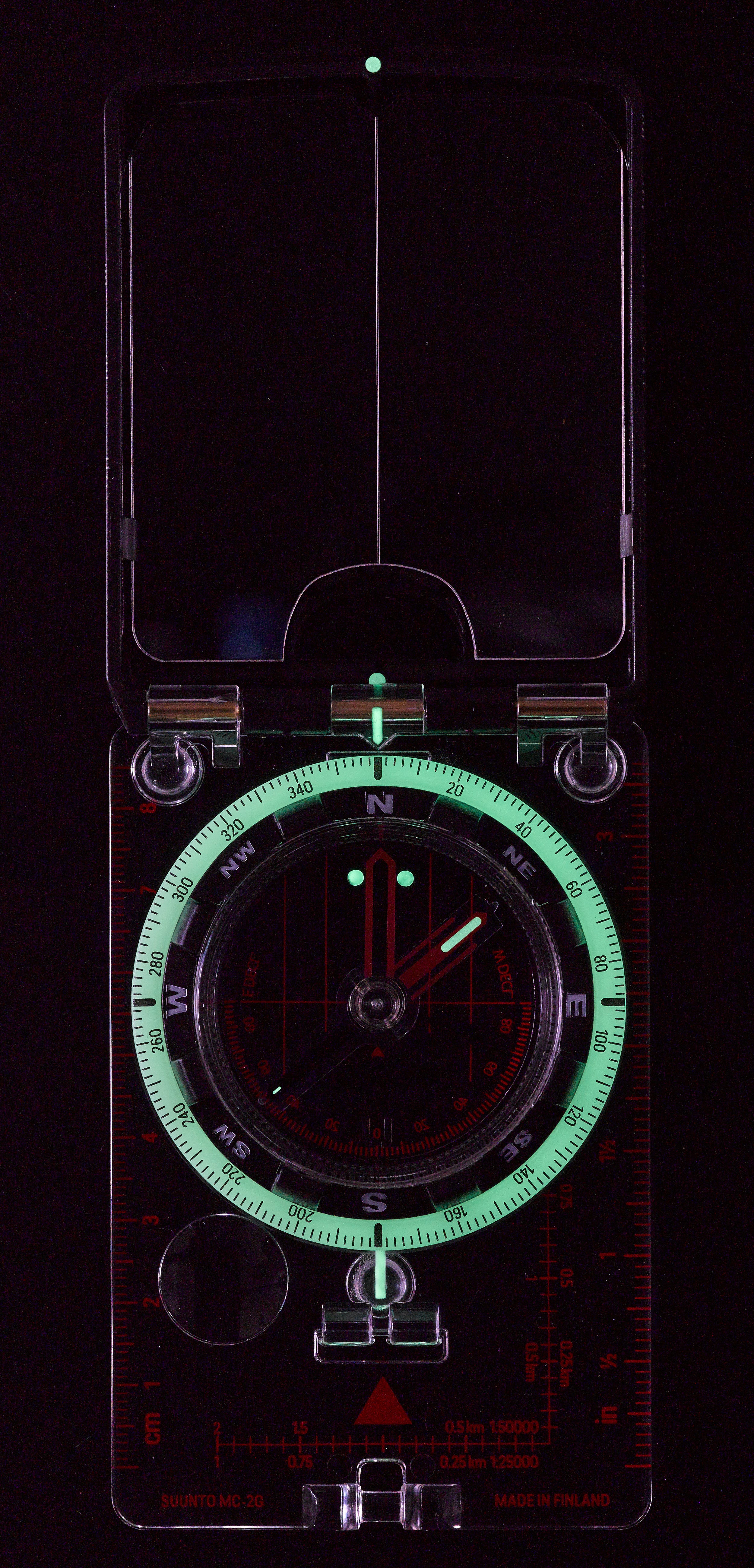

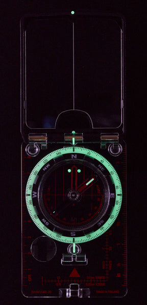

Luminescent features
Luminescent material: SrAl2O4
Compass Needle: Area on the north end of the compass needle and a narrow line at the south end of the needle
Orienting arrow: Two dots, one on each side of the north end of the orienting indicator.
Protractor: The material of the protractor on which the directional scale prints is luminescent.
Protractor index: Two lines, one for bearing and one for back bearing along the center axis of the base plate
Direction of travel: Two lines along the center axis of the base plate in combination with two features along the center line of the mirror lid.
