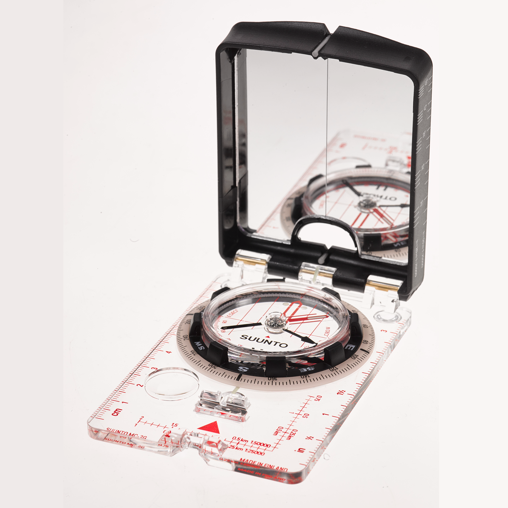

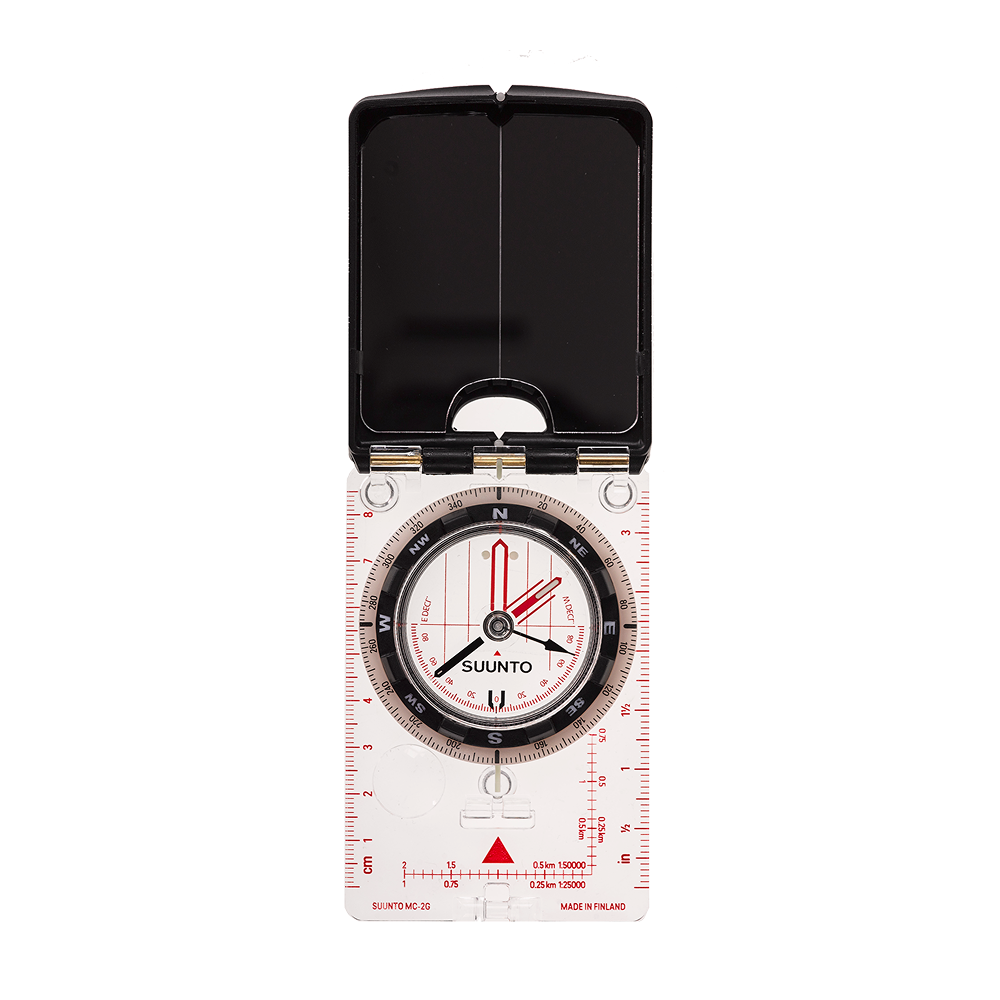

The compass consist of a transparent plastic rectangular base with a circular dial assembly with adjustable declination correction and a liquid damped compass needle, and a rectangular hinged lid including a mirror attached to the base. The compass is non-radio active, magnetic, unmounted, and suitable for field operations in extreme weather conditions.

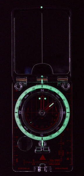

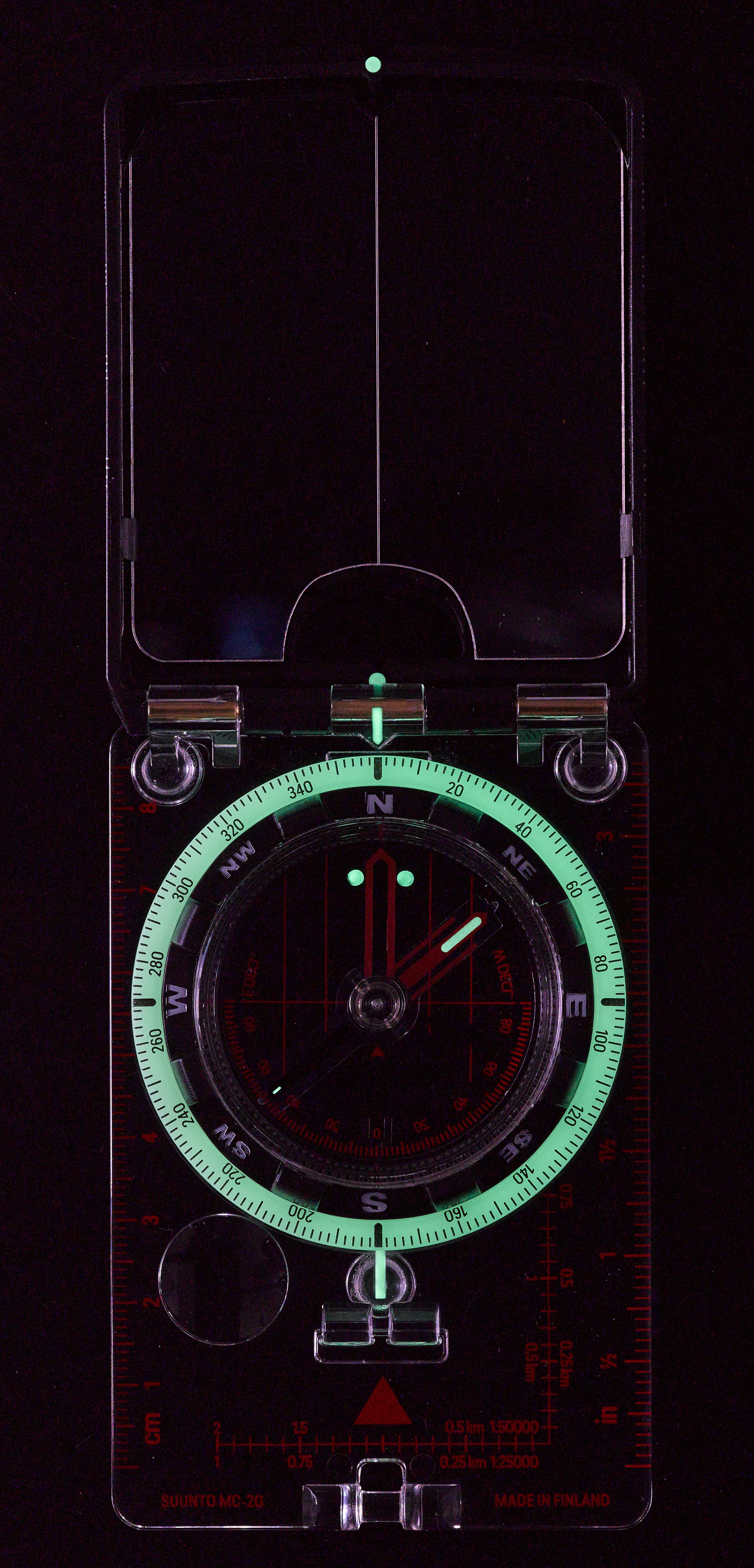

Luminescent features
Luminescent material:
SrAl2O4
Compass Needle:
Area on the north end of the compass needle and a narrow line at the south end of the needle
Orienting arrow:
Two dots, one on each side of the north end of the orienting indicator.
Protractor:
The material of the protractor on which the directional scale prints is luminescent.
Protractor index:
Two lines, one for bearing and one for back bearing along the center axis of the base plate
Direction of travel:
Two lines along the center axis of the base plate in combination with two features along the center line of the mirror lid.
