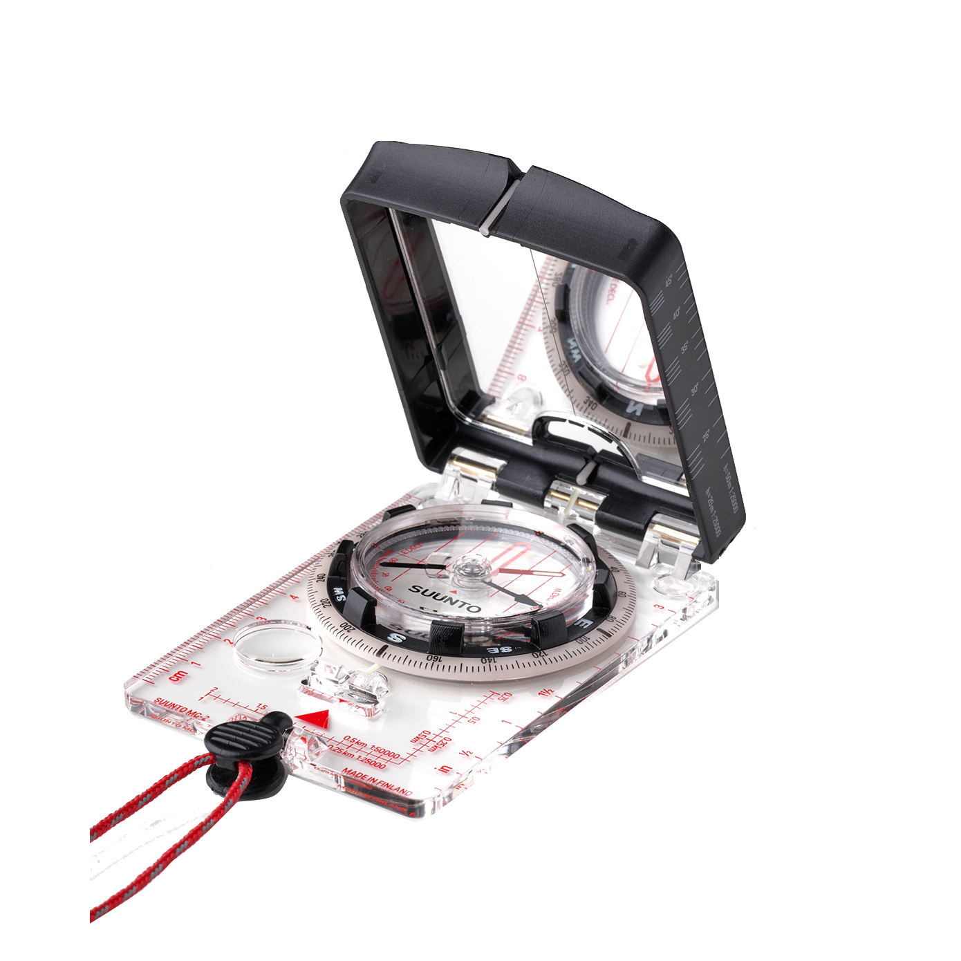

The compass consist of a transparent plastic rectangular base with a circular dial assembly with adjustable declination correction and a liquid damped compass needle, and a rectangular hinged lid including a mirror attached to the base. The compass is non-radio active, magnetic, unmounted, and suitable for field operations in extreme weather conditions.

Baseplate: Rectangular, transparent, made from impact and scratch resistant PMMA
Magnifying lens: Yes, 5x
Rulers and scales: inch, and 1:24 000 mi rulers, metric partial 1:24 000 and metric 1:50 000 UTM Roamers, Slope rulers on the sides of the mirror lid.

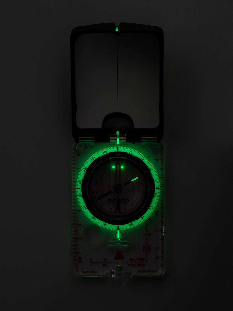

Luminescent features
Luminescent material: SrAl2O4
Compass Needle: Area on the north end of the compass needle
Orienting arrow: Two dots, one on each side of the north end of the orienting indicator.
Protractor: The material of the protractor on which the directional scale prints is luminescent.
Protractor index: Two lines, one for bearing and one for back bearing along the center axis of the base plate
Direction of travel: Two lines along the center axis of the base plate in combination with two features along the center line of the mirror lid.
