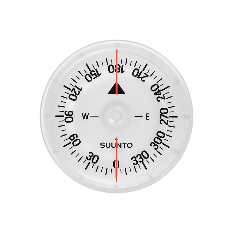

Compass capsule for building into dive or parachute navi boards or to use as spare capsule for Suunto SK-7 and SK-8 dive compasses.
Suunto SK-8
/Orca Capsule NH
Suunto item: SS021120000

Compass capsule:
Hermetically sealed transparent PMMA capsule, diameter 49 mm.

Compass card:
Fully luminescent with black print
Protractor index:
Line in front of luminescent compass card
Direction of travel:
